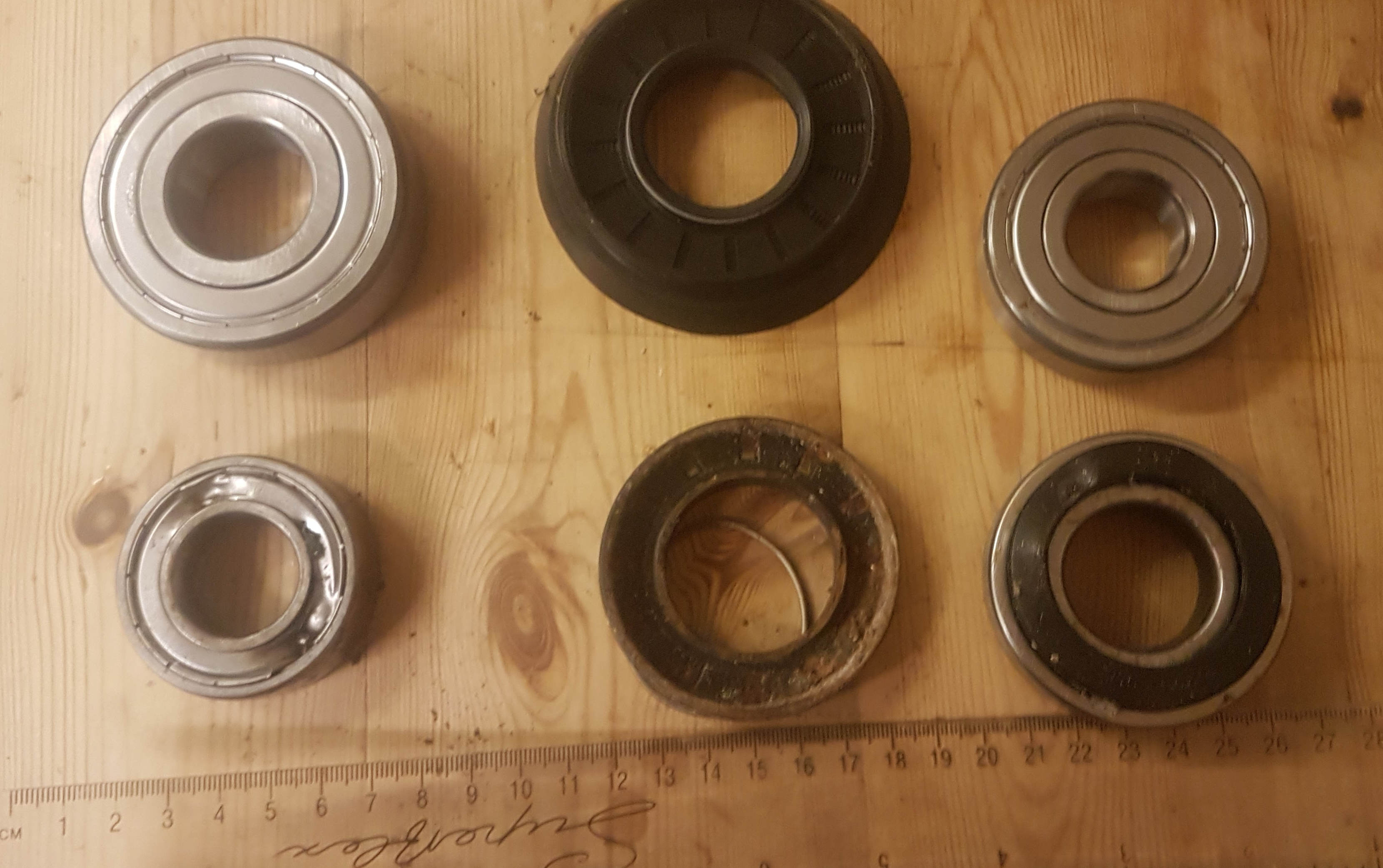

I ordered  a new set of bearings and seal for my LG WM-123111FD washing machine from buyspares. They are listed for the right model LG washing machine. But the seal I took out is much smaller so is the inside bearing. Looking on other web sites they seem to supply the same set of two bearings and seal for this model.  How do I go about finding the right bearing and seal? I have pictures if anyone can help. I would have thought that specifying the model and serial number was sufficient to determine the correct part. Is there a service manual or parts list that would help?

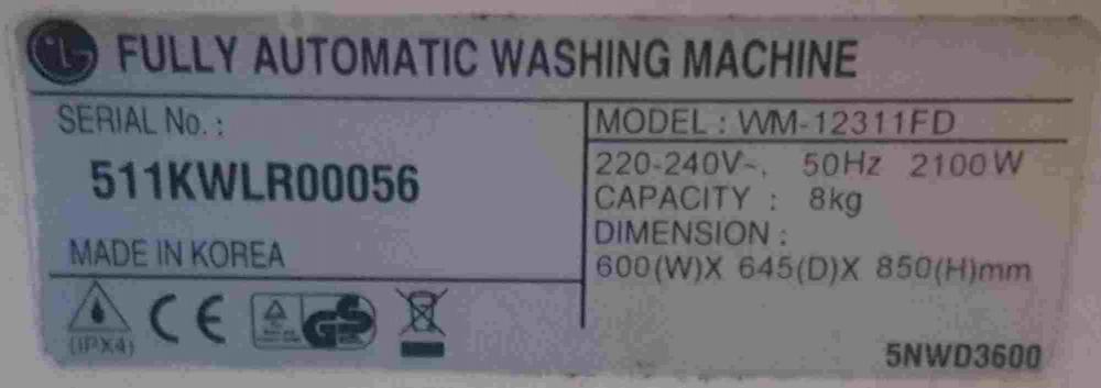

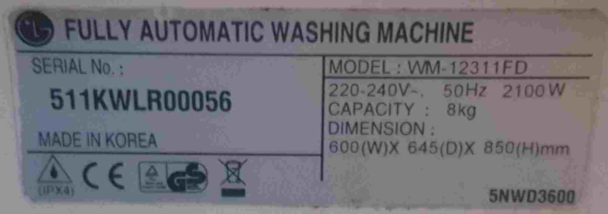

Sorry WM-12311FD is the model number, my mistake. Web sites dont seem to use the hyphen. The serial number is 511KWLR00056 In the photo top are the set supplied and bottom the set removed
It's often extremely difficult to find the right parts. Even engineers with all the manuals have constant trouble. They commonly fit different parts to different production runs for the exact same model. I've known some models have 3 possible different types of part fitted depending on the month and year they were made. To my knowledge there are very few spares counters left. Try searching for appliance spares counter near where you are. However they are likely to be working on the same information as the online ones.

You can usually buy bearings from a bearing company as yes, they tend to be very standard design with only the sizes changing. The numbers on the old bearings can usually be used to source from a bearing company. The seal that protects them however is not available elsewhere.
Thanks for the advice. The spider was broken and I have the machine disassembled down to the drum and it is a job I have done a few times on different machines over the years. In fact I am so old I fixed my granny's twin tub as a kid, and a Hoover keymatic with my dad.  So as I had it stripped down it makes sense to replace the bearings and carry on. It is quite a lot of disassembly. In fact the screws on the spider were the hardest part as they were s/s screw corroded in to the alloy spider. That needed precission drilling as well as suitable drill bits.  EDIT I was just reflecting compared to the last time I replaced a bearing on a hot point in the 1990s, it was so easy. Direct drive motor so no belts AT ALL!. Not really that much to dismantle . Nice tidy easy to remove wights. And plenty of videos on you-tube so you know what to expect. I was really pleasantly surprised by the engineering of this LG, until I got to the spider. Uncoated aluminum alloy, fastened to stainless steel and to mild steel in a corrosive electrolyte.  Someone at LG needs to go back to metallurgy school - unless this is planned obsolescence.

I now realise that the new spider has the new bearing sizes, so actually I need a new rear drum casing with bearings. That solves it but it is annoying that LG cannot use consistent parts and tell suppliers what they used.
