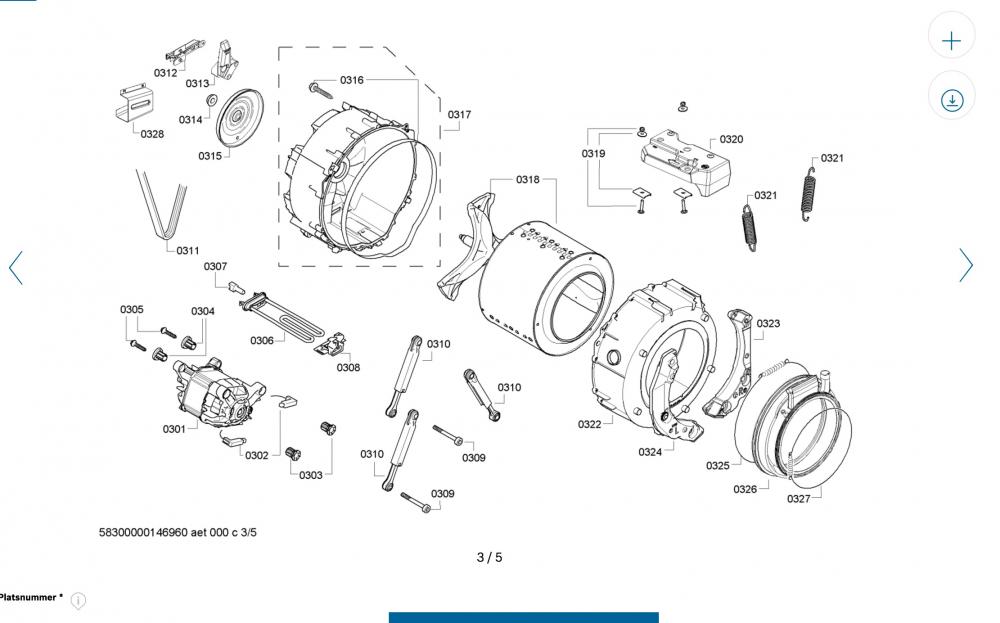

Before when the dry-cycle was running I could feel the heat in the room. Now it's no heat and the wash doesn't get dry after the dry-cycle. I thought it was the same heater for both. Anyway I swapped parts 0306 and 0307.

The dryer's heating element should be on top of the outer drum.
