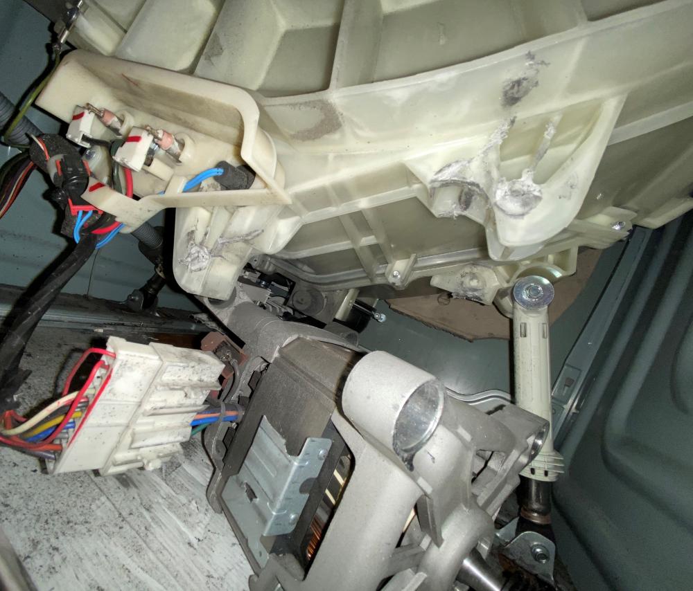

Need some advice please ,we  have a 3 year old Samsung Eco Bubble machine (£400 approx.) that went bang during its spin cycle. On investigation the belt motor that sits at the base of the plastic drum, has fallen off the plastic drum , and now sits an the kitchen floor with the drum belt. Turns out that the 4 mounting bolts that hold the motor casting to the plastic have all sheared and the plastic mounting points have all smashed to pieces .Machine  is out of warranty (just) and the expected replies from Samsung are weve overloaded it and its not level.

The motor fixing mounts on an outer drum can't come off if the washing machine is overloaded or not level. That would be a very poor design indeed. The motor should never drop off. If the machine has been making a strange noise on spin for some months though and it was ignored then it's arguably something that wouldn't have happened if it had been attended to early.
The only way the motor could break away is if the plastic fixings just aren't strong enough, or had a fault in the mould, or if the motor started to come loose and has been shaking about for months until it damaged the fixings.

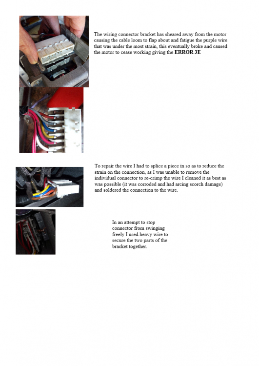

My Eco Bubble after a year of battering it insides with every wash finally committed suicide with a 3E (motor) error message.
The problem I found was the two screws that hold the motor in place had loosened enough to allow the motor to slop about, this was in my opinion worsened by the lack of any bushings on the mounting posts giving a 10mm overall slop!.
The continual excessive movement caused strain on the motor connector bracket which sheared and allowed extra movement on the wiring loom eventually leading to the shortest wire to break and give the 3E error.
I fixed the problem myself as the machine is needed daily and we couldn't wait for an engineer even though there is still a year left on the supposed '5 year warranty'
I have uploaded photos of the problems I found in the hope they may be of help

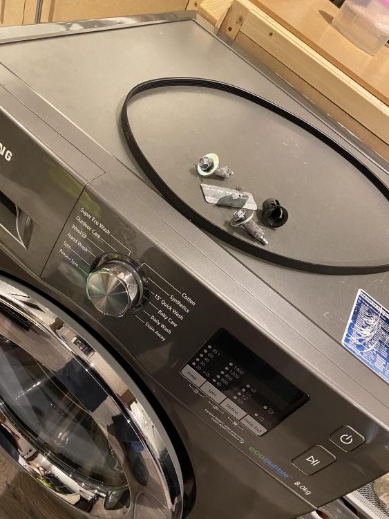

My Samsung Eco Bubble Washing Machine did the same in October 2020 when it was spinning at its fastest 1400 RPM. Went with a bang! I too opened mine up to see the motor sitting there on the floor. Bolts just ripped out and 1 moulding at the back of the motor was sheared off. I managed to fix it but it is a temporary fix so it is acting as our secondary machine for light loads and slow spin speeds. This must be a common issue with Samsung Eco Bubble Washing Machines :(. I've now gone to LG and it is so much quieter!
