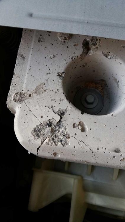

It now makes a loud knocking noise during spin cycle (800 rpm and 1600), almost deafening in fact. It fills with water and goes through a washing cycle but the clothes don't wash properly - e.g. I can see brownish spots on my light coloured shirts.
From the research I have done it sounds like it might be the bearing in which case I would have to replace the sealed drum for £140 plus (aint gonna happen I can buy a new one for that). However, I would like some input from you guys who will know a lot more than me.
A few more points, I removed the back and top panel and had a look around and theconcrete block on top of the drum has crumbled (see pics) - now this could have happened as the fault as developed or since the knocking started 2/3 days ago. When I first installed the washing machine I had to wedge it between two walls with foam pads to stop heavy vibrations (this was 2 years ago when we moved in), I made sure it was level but the vibration through the wooden floor upstairs was still way too loud - maybe the damage was done because of the foam padding hiding the problem which gradually got worse? Ummm.?

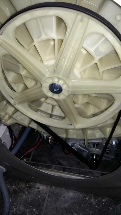

Anyway have a look at the pics - the pullies left and right which support the drum are perfectly intact (I assume there isn't one underneath the drum), belt is very tight and motor looks v.clean)

Hello. Drum bearing failure is a serious fault these days due to the way the washing machines are designed. Brown spots can also be a symptom if rust and grease from the failed front bearing get onto the laundry. However, a loud knocking noise on spin can also be caused by a loose drum weight.The weights in the photo look pretty poor but if they are still tightly attached to the drum and can't be moved they won't be causing any noise. There's usually more than one weight inside a washing machine though.

Whoa!  The lower concrete block has probably come loose; we have the exact same model and I fell for the bearings being the culprit.   Have just had machine apart.  The plastic 'turrets' that the block mounts on frets along with the concrete, making the block clunk horrendously; sounds terminal on spin!  The block is held on by three Torx screws.  Remove them, lift the block away.  Cut the screws down by 5mm with an angle grinder (this means you'll get them to tighten fully on reassembly).  Apply a PU adhesive/sealant (such as Tiger Seal) around the turrets and re-assemble.  Tighten screws fully.  Leave overnight for the PU to cure.  Fixed.
Wow. I didn't think it was possible to repair. I wouldn't be surprised if they work loose again so keep a close eye (ear) on it. The weight causes a lot of destructive force on spin. Good luck.
