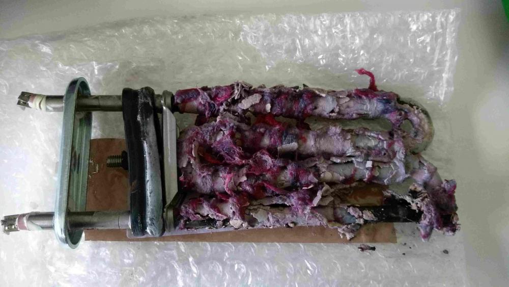

I managed to get a photo of the failed element this time - see attached.

Wow, that looks in a right state. It looks like it's been in over 10 years. You need to work out what is causing all the loose fabric or cotton threads to wrap around the element. That won't help. It looks like it's got limescale on it - but there shouldn't be a spot on it by now. The only thing I can think of that could cause an element to get covered in limescale so quickly is either serious under-dosing of detergent, or something going wrong causing the detergent to get lost somehow. That would be very unusual. However, weird faults may have weird explanations.
Using a decent detergent designed for front loading washing machines and using the recommended dose for the hardness of your water and soiling of laundry should totally protect the element from limescale. If limescale is covering the element after 3 months it must be operating in water that hasn't been softened somehow.

Just looking at the top of the element, at the terminal end it seems the insulation maybe cracked ? if i'm wrong, sorry..... but would low/now working temps affect things...? I'm like others, just looking for reasons to help....
Hello Raymond. If the insulation is cracked it could leak to earth and cause fusing. It would need testing with an insulation test meter.
