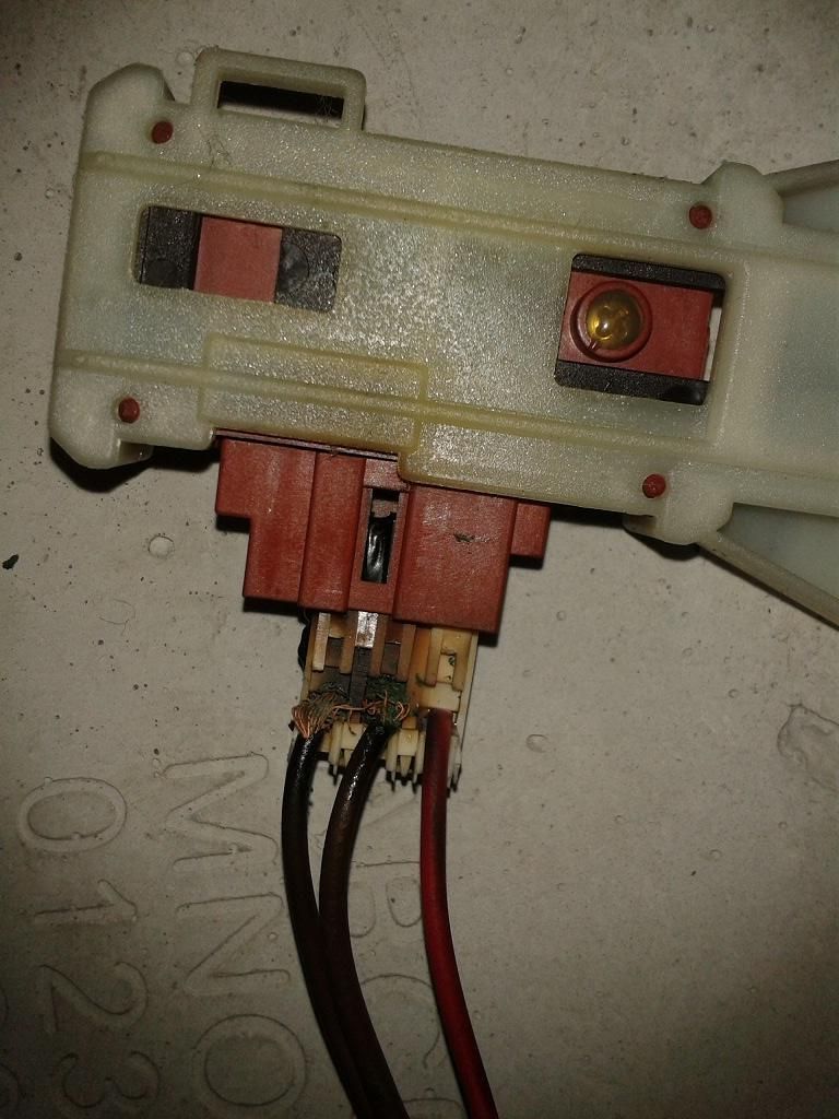

I had a look inside and found that the door locking mechanism seemed to be burnt out.
Do you think buying a replacement part will do the trick?
Posted Image
That looks nasty. It's probably worth a try though it's possible the short could have damaged something on the pcb. There's clearly been a poor connection which has caused excessive heating so both the interlock and connector block would need replacing. The wires would need cutting right back to get rid of all the hard baked wire and reconnecting with a replacement connector so it depends how much extra wire you have in the harness as to whether that can be done easily. Some wires can be re-routed to give extra length. The connector may be hard to find as a spare part though.
