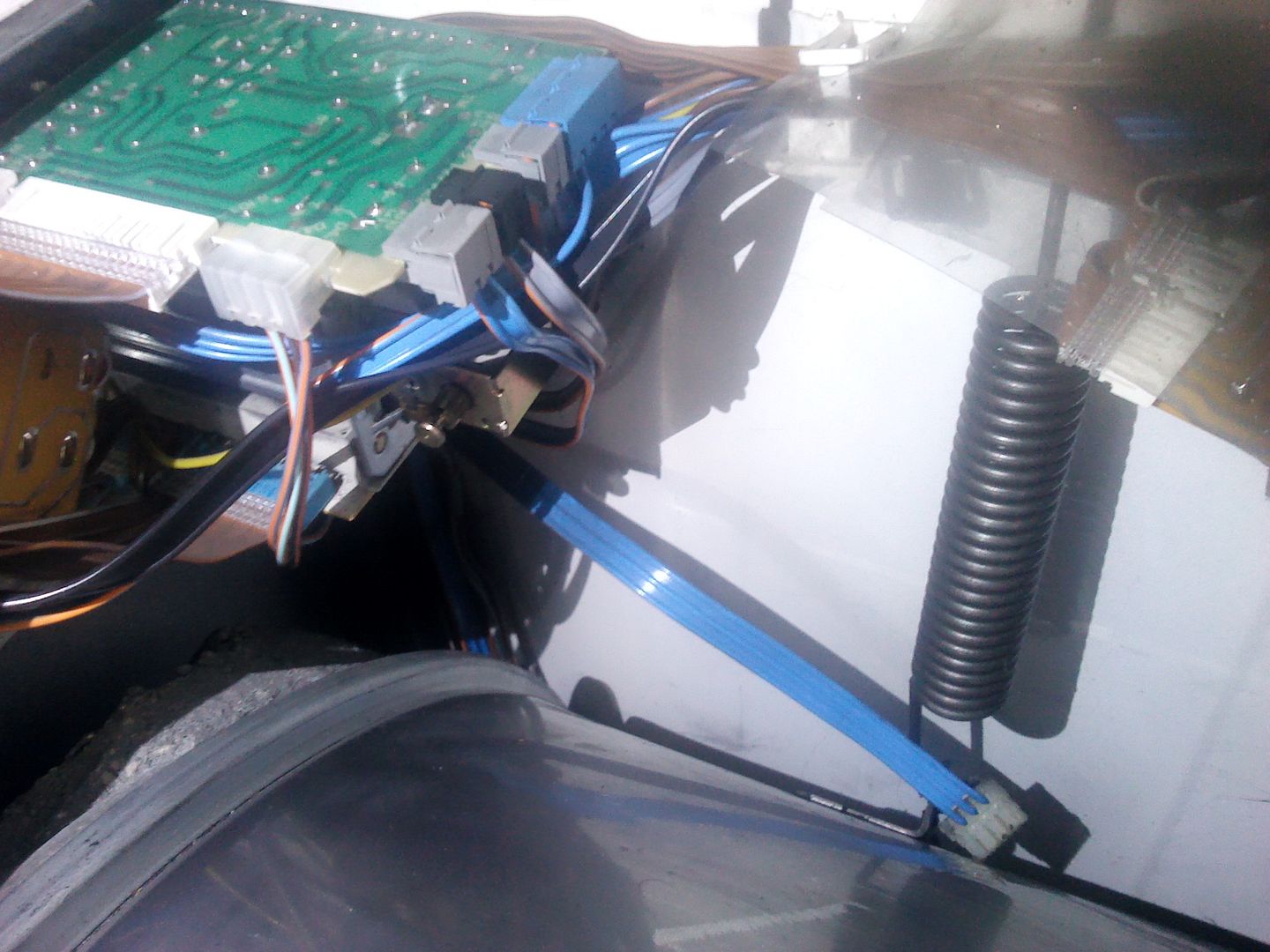

It's highly unusual for a connector like that to fall off. However, it looks like it could potentially fit on the corner though at the same time the connector looks just a little too big. If you can see where it came from then it may have come off, but a connector like that can't just fall off, they are very firmly connected.
It is possible sometimes for the tub to jump up violently and break one off, but it would normally literally break it off not pull it clear. Sometimes there is a spare connector within the harness, or even one designed for engineers testing only which has never been actually fitted. You should be able to work out if the connector naturally fits anywhere, you should be able to see the marks though on the programmer's connector board where the connector has previously been fitted.
Thanks, have had a good look and can't see an empty spot. Must be a standard loom like in cars.
Any idea on first post problem?
