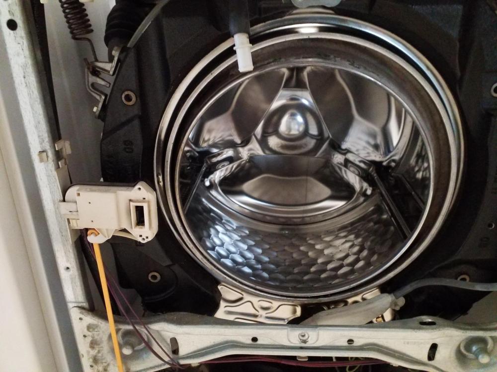

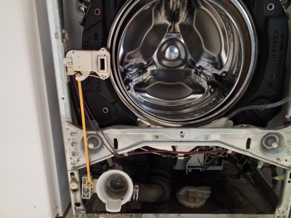

Not yet, as I have been taking my time removing things and taking photos, so that hopefully I will be able to put it back together lol. But I hit the honeycombe drum with a rubber mallet in a few different places. And the drum did move a little. So I think that your advice as to it being a bearings problem is correct. I will keep trying little by little to remove things to be able to get to the part wgere I can remove the drum etc & look at the bearings. However I think maybe it will have caused damage to the spindle?. I cannot find anywhere that sells the complete drum set. But again many thanks Andy for you prompt reply. I will keep you in the loop as to how things go.

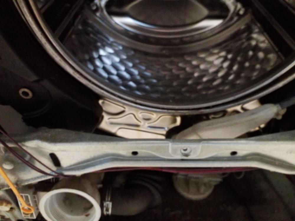

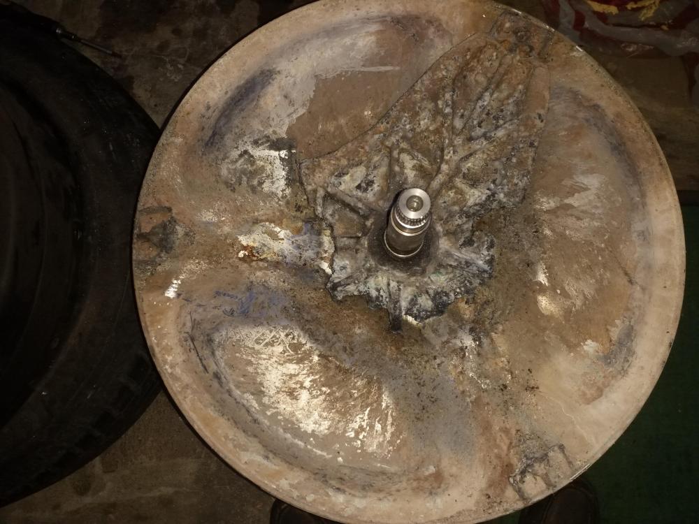

Hi. Andy.
We have stripped the machine down today. The bearings seem fine. But I am including some pictures of the problems. I think that item 1. Is called the drum shaft seal. But cannot read the part number. And also same problem on item 2. Any help you are able to provide, will be extremely helpful.
T.I.A. Mark
Hi. Numbers on parts are useless in all cases I'm aware of. They are usually manufacturer numbers from China or wherever they are made. The part number required to order a replacement are always totally different. The only exception I'm aware of is numbers on bearings which include information that a third party bearing manufacturer can use to supply an equivalent.
That looks like it's extremely badly corroded. I think I can say with reasonable confidence that it will be way too expensive to repair. But a bigger problem than that is that as far as I'm aware, Miele no longer supply any parts for that model.
